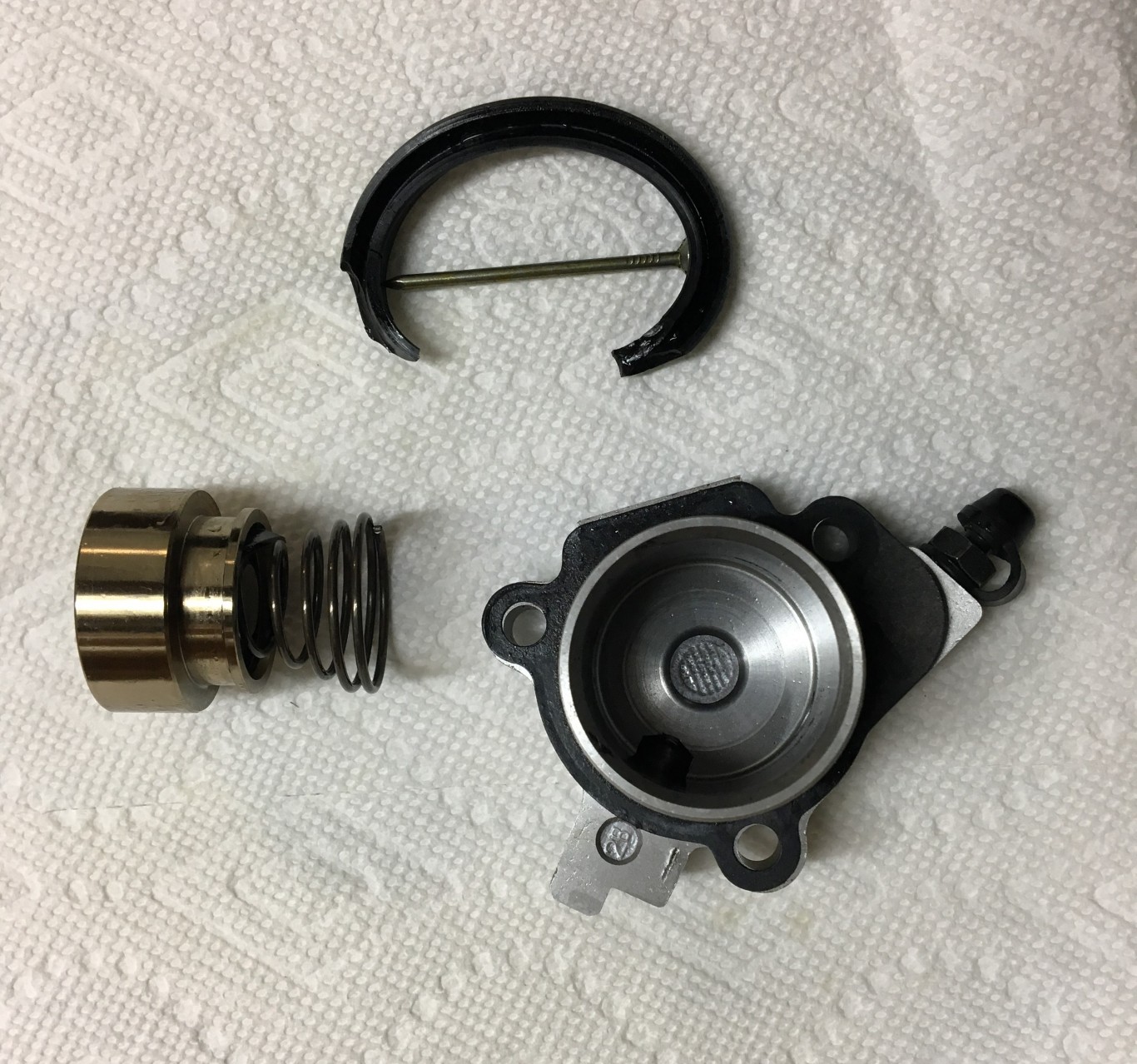

Pictured is the broken clutch slave cylinder piston rubber seal (that caused the leak), piston/return spring, slave cylinder.....
Had I known what the issue was, I would have considered buying the $90 clutch slave assembly and gasket and replacing this myself.  It didn't look all that difficult to replace.  But when you've never dealt with an issue like this before (although some Tiger Forum posters appear to have), and neither did the dealer tech who repaired it (he said he worked at the Triumph dealership for 8 years and never saw one like this happen before), you get the dealer expertise with your dealership experience.  Spent $130 for the labor portion of the repair (1 hour), which I thought was fair.  High, but fair.  $241 in total (included brake fluid, etc.).
On the ride home from the dealerhip (~21 miles) clutch engagement during a slow easing-out of the clutch lever was notchy (felt it shuddering).  It was fine after the clutch lever was let all the way out.  The tech said to see if that goes away after the engine oil change.  The shudder diminished after the oil change (changed it as soon as I arrived home).  Still there, but not as bad.  Not riding it much more now for the 2018 riding season.  I generally stop riding when temps hit 40 degrees--I have other "fun transportation" options.  Hoping that the brake fluid on the clutch disks eventually wears off next season.
For what its worth, my tech said the replacement slave piston and cylinder (Triumph part) design was new.  It has a double-seal design now, which did make me feel better about lowering the likelihood of this happening again, but one of my riding buddies has a 2013 Trophy SE (40k miles) that he rides pretty darn hard with the same engine that this hasn't happened to.  Oh well.  It's over.  I'll just have to keep my fingers crossed that the shuddering goes away next season andi the new double seal design does the trick.
