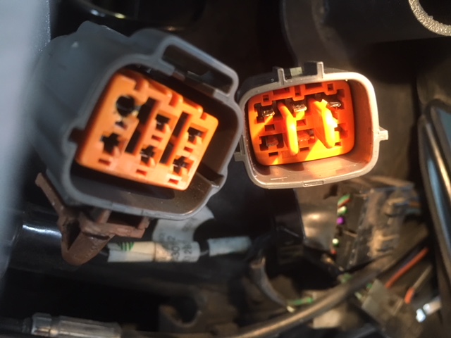

*Originally Posted by Giraffe [+]
Finally found the fault. Headlight feed to lights at the terminal block located in the front of the frame under the tank on the right hand side. Grey terminal block clipped from inside the frame. This necessitated removing the front trim. tank retaining screws and the fuel balance pipes to the front (tank required draining but only lifting backwards to gain access) :001:
Image of terminal block is saved to the Photos Gallery
WQgQ.htm
Admin Edit: You mean this image:
Hi Giraffe,just to let you know my low beams went on my 13 explorer...exact same prob as you had,thanks for posting it on the site,it was an easy fix when I knew what I was looking for
