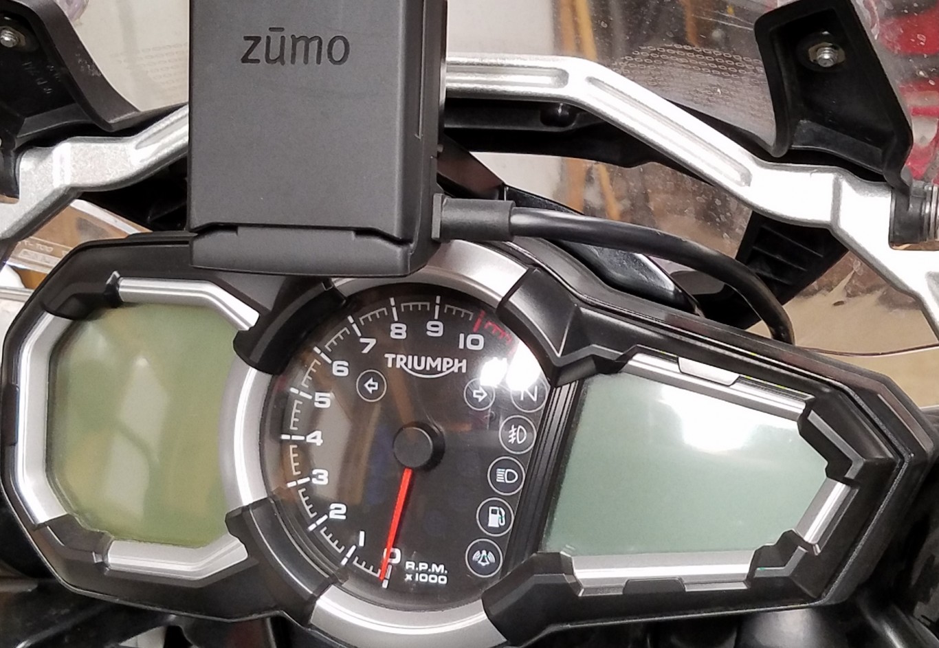

I ran the wiring harness for my 595 around the back of the instrument cluster, then under the plastic that covers the wires, cables and hoses at the front of the frame.
Then under the tank and back to my fuse block.
I clipped off the cables I knew I wasn't going to use to make the routing easier.  I only kept the USB port (can't have too many of those) and the power leads.
Mount and harness cable.
I had to make an extension cord for my Denali driving light dimmer relay- I could only use the seat in the low position with the relay on top of the battery.
The the cable for the USB port from the GPS loops around the toolkit area.
