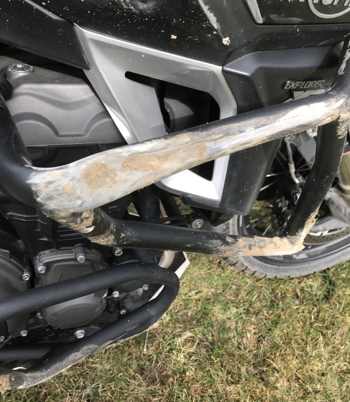

Well my Heed bars looked like this after the Kielder 500. I've dropped my previous bikes before whilst learning and I mean dropped not crashed and they've saved their price in body parts for sure. But this was a slightly faster crash and including replacement bars at £150 the parts bill was £500. The tiny panel by the clear wind deflector was £100 on its own. If I'd needed the section along the tank then I dread to think what the bill would have been. Anyone con drop a bike or have it knocked over by someone else. Each time that happens, the bars are paying for themselves. I'd love to be able to say I've never dropped mine but I have. Stuff can just catch you out.  The Missus has dropped her 800 a few times, but a quick rub down and a spray and she's as good as new.  :745:
Following a drop they repair invisibly. Following a slow fall, they're pretty much consumable items - I wish they sold them in single sides! Once they're bent, they're no good really.
In terms of a high speed crash, well if I'm honest I think the bikes going to be a write off regardless of bars or no bars.  Just check out Triumph body panel parts and decide whether £150 for Heed, Motech etc is good insurance.
As a footnote, I'd say the Heed ones for the 800 in case you have one too, are a poor design. There's a yoke that attaches to the front headstock subframe (that's the bit that carries the clocks etc etc) and it simply doesn't not prevent lateral movement. If you drop the bike, the whole bar on one side pivots around the headstock mount and you don't get full protection. The indicators are the first casualty at £50 each.  I made a different mount for my Wife's that clamps much better and following the last episode at the seaside, seems to have done the trick. Lenses are only £7
