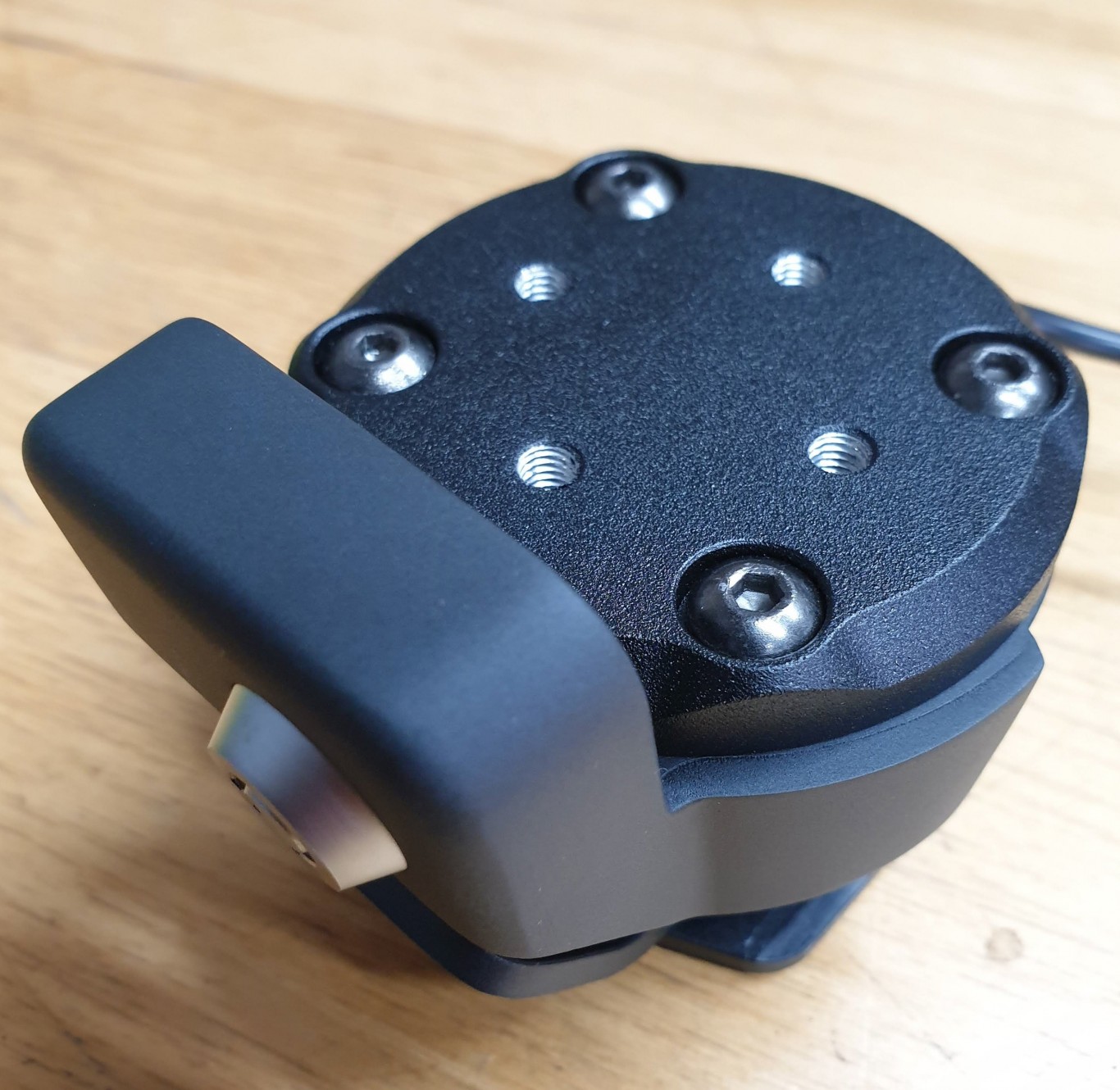

The adapter plate for the TomTom option is nicely machined, and replaces what would normally be a RAM ball...
This adapter plate is then fixed to the main bracket with three bolts (but there is no adjustability in the angle)...

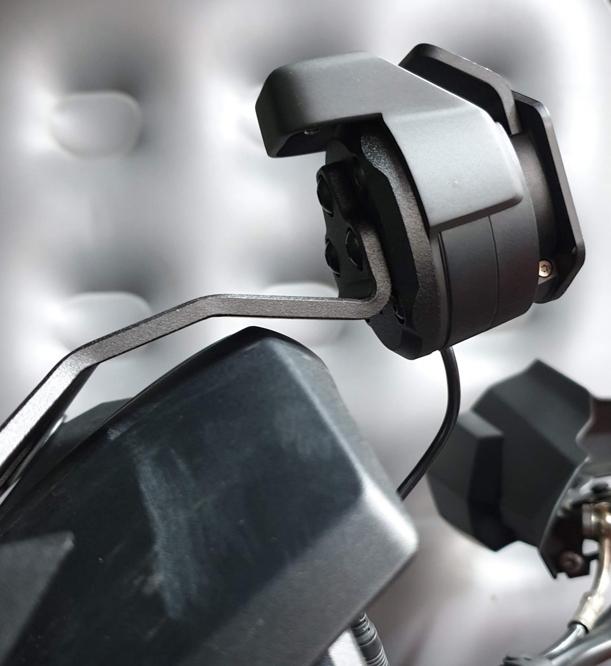

I've installed the mount upside down so I can still use the TomTom theft solution...
This also has the added benefit of providing somewhere to tuck the power cable connector!
