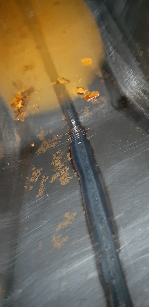

All ready for a run a few days ago, bike started OK, the idle was rough, but stalled as soon as I opened the throttle.
Took the fuel pump out today to find this.
Somewhat upset, especially after finding out that the filter can't be cleaned or replaced.  Whoever thought that was a good idea needs a  :192:
Heading away for work for 3 weeks, so I'll have a go at getting into the filter when I get back, and post what I find.

I am also a member of the 1050 forum and one of the guys did a strip down of the pump and filter on there if its the same   Note the specific way the cable loops around top and a new zip tie if not already done
https://www.tiger1050.com/index.php/topic,39446.msg433767.html#msg433767

Is that staining in the bottom of the tank (not the obvious pitting) or just the way the picture has come out?

Jockmaha, thanks for that, I know what I have to do now.  Looks like I need a run up to Inverness to buy you a pint.   :821:
Hax, just a bit of staining, it does look worse in the photos.  From classic bike forums, ther eis a liquid sealant for old tanks that'll coat the inside, so that's the route I'll go down.
I'll post pictures etc. when I get round to this just to share the knowledge.
