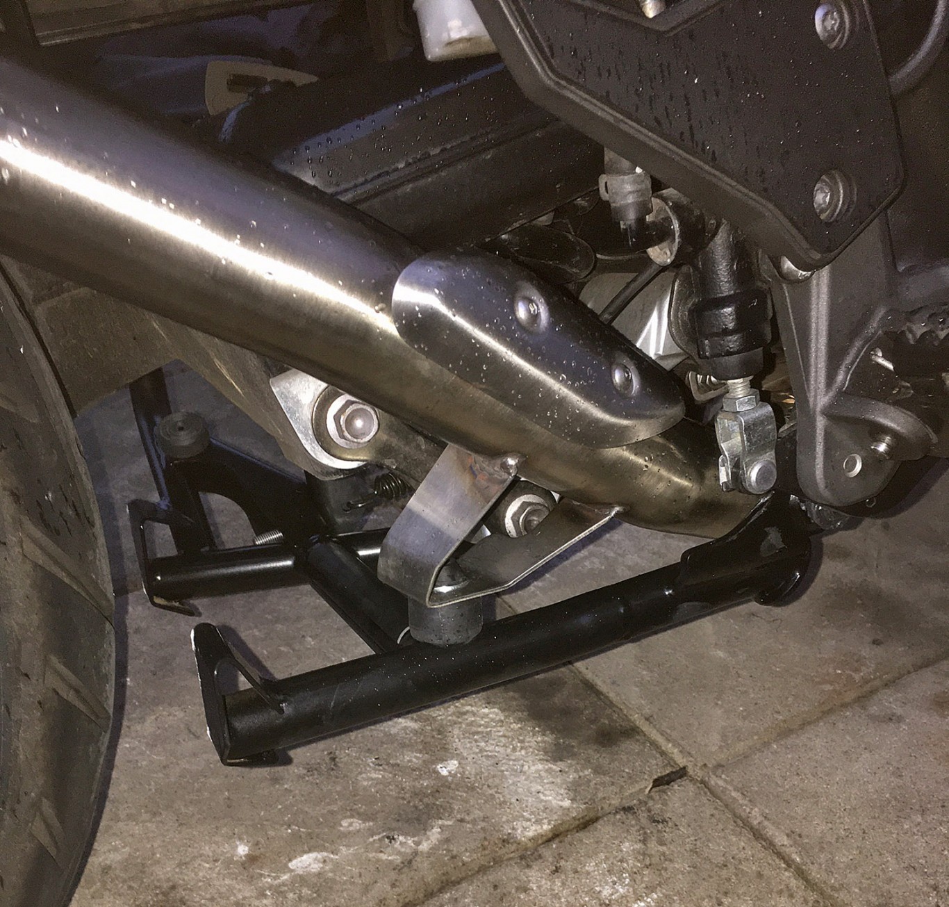

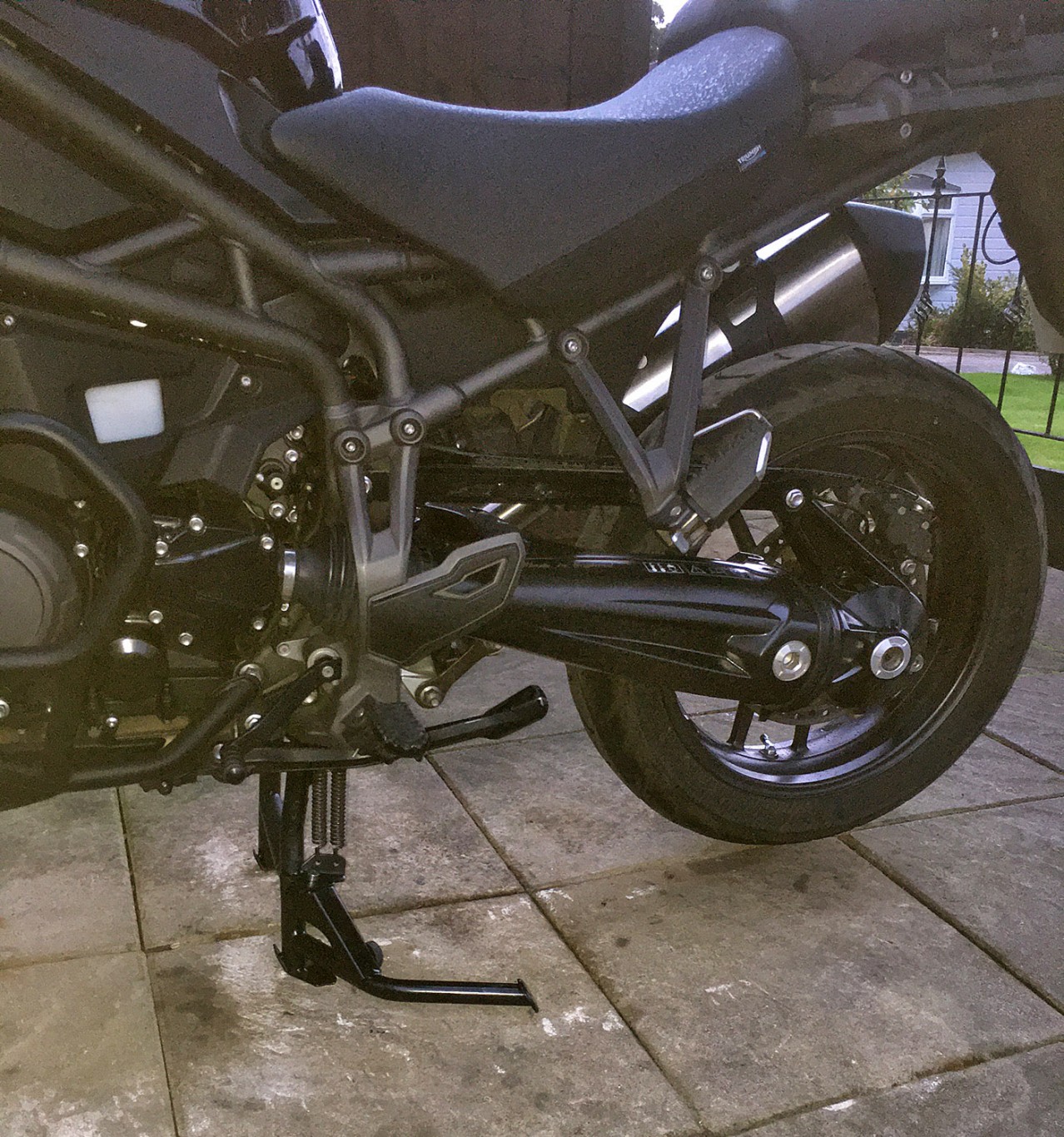

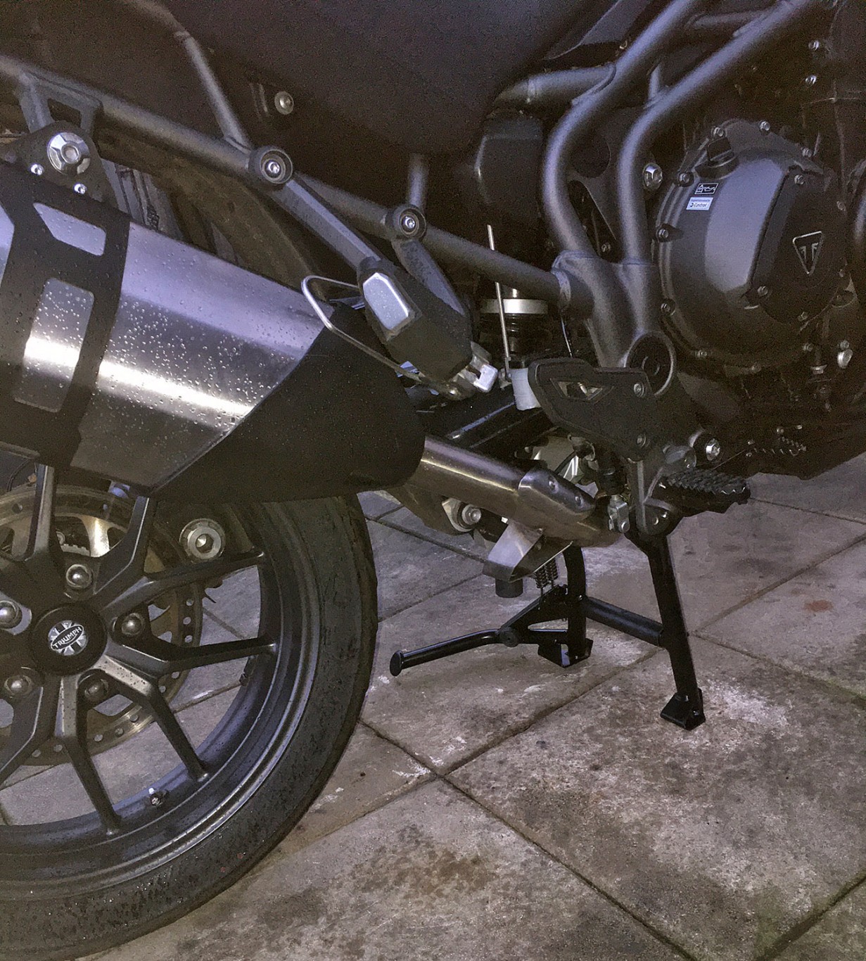

Finished
Reply #22 on: October 12, 2021, 07:17:39 PM
Hi y'all..
Silencer arived at my place of work today..
Its a very nice conditioned OEM silencer off a Gen 2 Standard (None Low).
I was planning to fit it and the modified centre stand on Saturday.. But I was in the mood and so its now FINALLY all done and finished.
I know I have commented before on Triumphs attention to detail and build quality...
But little things like the extra long allen bolt that holds the bracket for the centre stand springs.. It means you can wins the bolt out by around 30-40mm and so it makes fitting the new (shorter) springs a doddle.. You fit them with the bolt unwound, which is easy and then simply tighten up the bolt.. Brilliant triumph..Well done!
I also like the O rings that are fitted to the center stand pivot thingy (T2083340).. That keeps the grease in and the water / crap out..
Its now all fitted and it "officially" works absolutely brilliantly.. In fact its so easy to put onto the stand that you forget how heavy these bikes are..
I grease the pivot VERY thoroughly with a home made mixture of Lucas synthetic grease and Honda Molyslip assembly paste..
Lastly, you will note that the Center stand rubber stop pad fits the modified stand perfectly (Photo 3)..
Now for the photos......
All in all with the welding (£40) and the Powder coating (£30) it cost around £220 (S/H Stand off eBay which was literally like new).
Yes its pretty expensive, but because it works so well I do not regret it for a second.
This mod is recommended.
S
