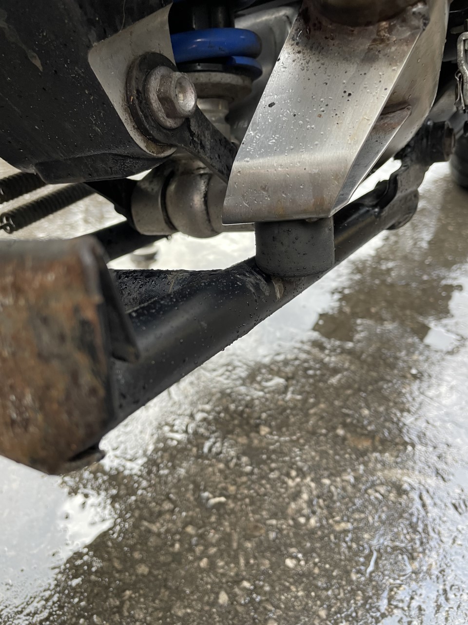

Reply #5 on: October 24, 2021, 06:23:43 AM
This is with the stock exhaust back on, and this doesn't line up either now?!?! :027:
I got them to swap it back, so I have paid for three exhaust fitting sessions and currently no exhaust lines up.
With the Remus on, the rubber stop was entirely outside of, and thus not stopping the stand.
Hopefully you can see what I mean.
I had some insurance work done on the bike this year after someone drove into me and I am beginning to think that maybe the stand is not perfectly straight

Reply #6 on: October 24, 2021, 08:24:34 AM
With the Arrow can many owners were having problems with the rubber stop not lining up on the centre stand. It was all down to the join pipe coming lose and the whole silencer swivels. Worth having a quick look to see if you can loosen that and align it yourself?  See the following video, but it is a long shot if three attempts at fitting have been made. If you are hearing a metal to metal noise check your rubber is not missing on the left as you may be damaging the drive shaft as in the video.
I'll take some measurements of my stand relative to the rest of the frame later on today and you might compare those to yours.

Reply #7 on: October 24, 2021, 10:21:57 AM
Yes, make absolutly sure that the downpipe is completly  in the centre pot. That did it for my t12. Unfortunatly it started within a week to move back again. I drillen a small (3mm) hole behind the clamp and inserted a rvs screw. Now it can not move forward anymore.
