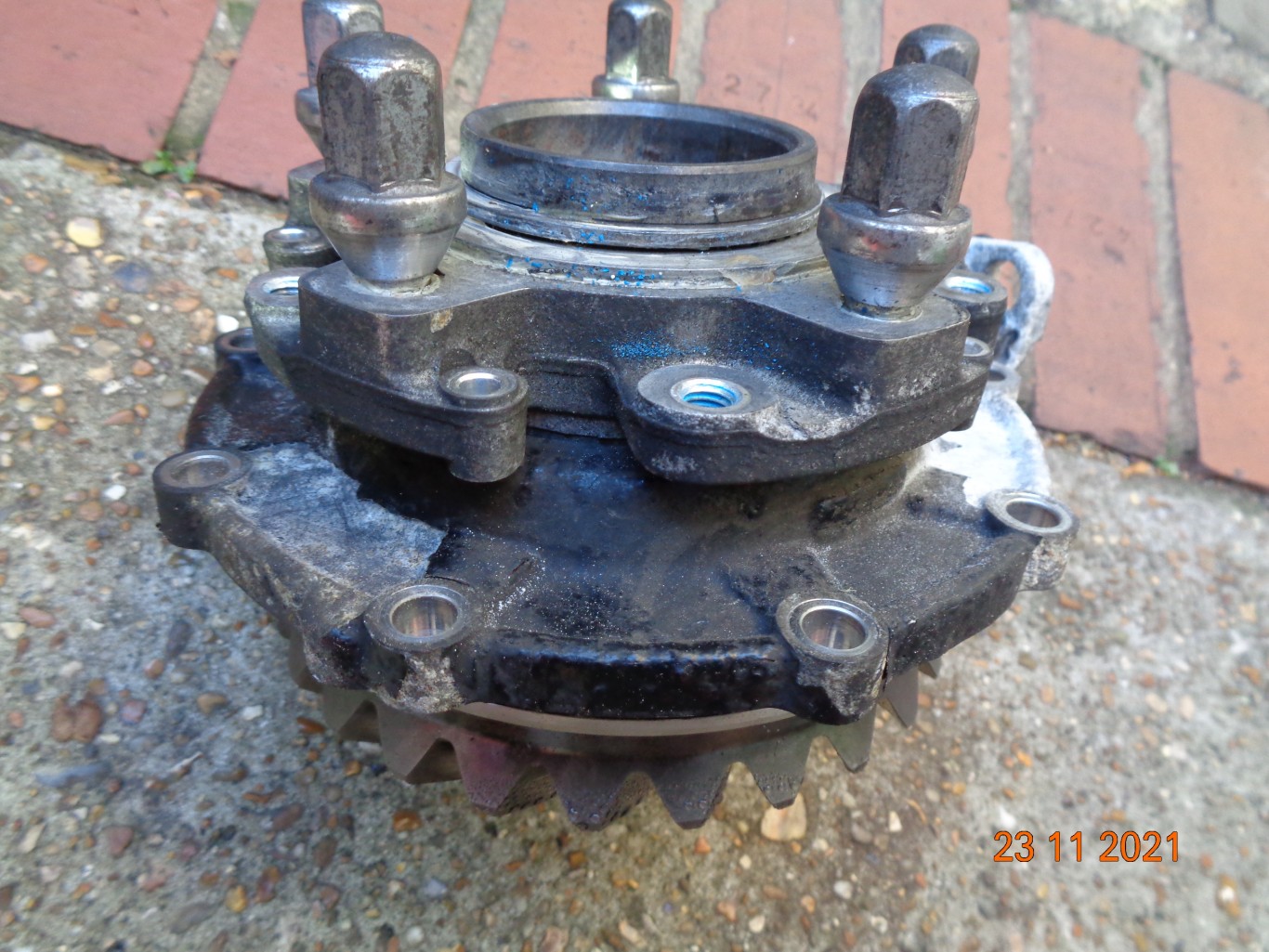

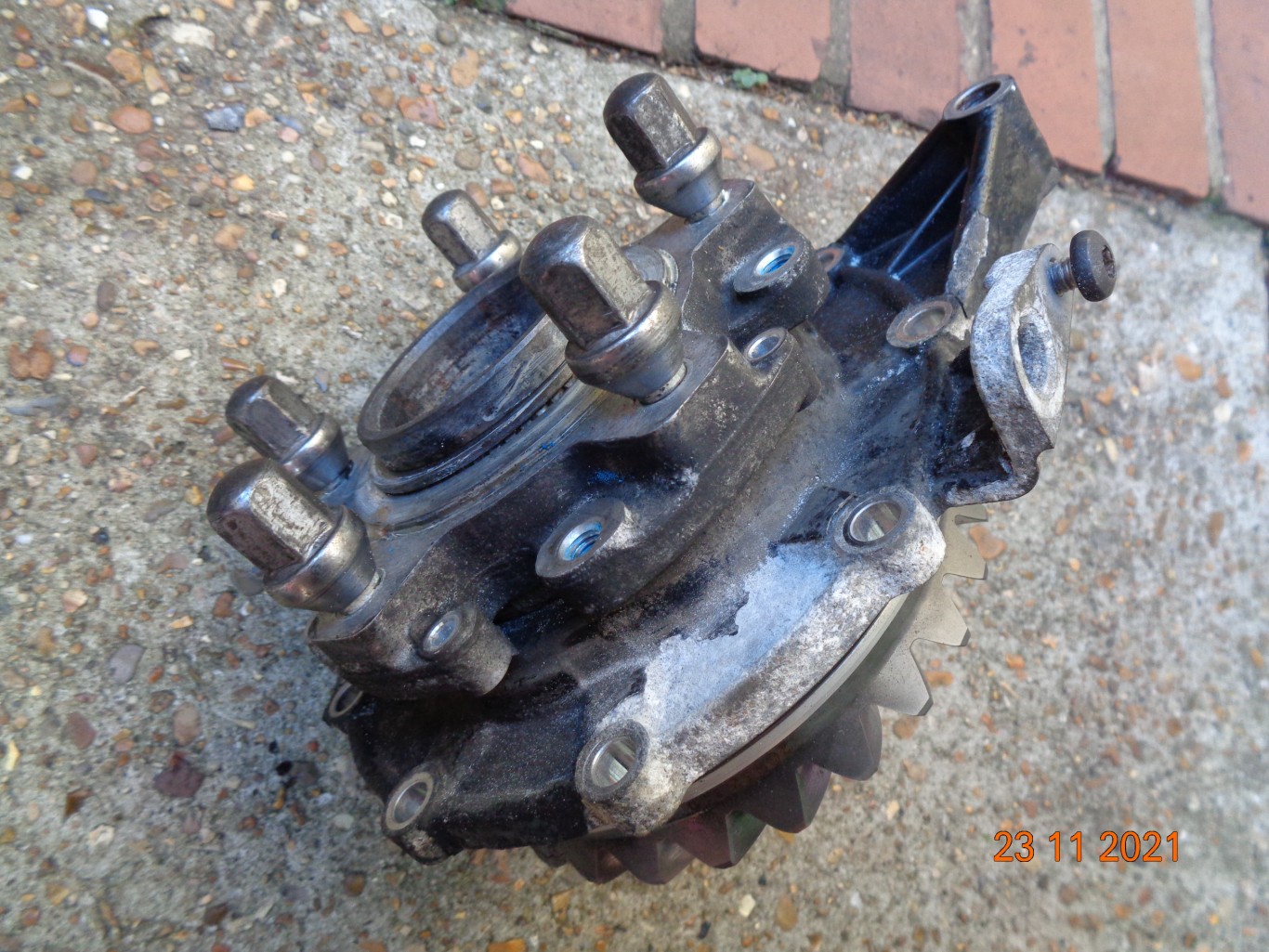

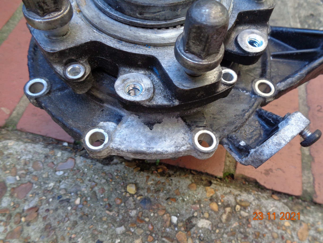

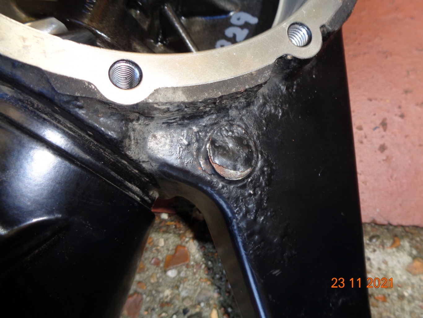

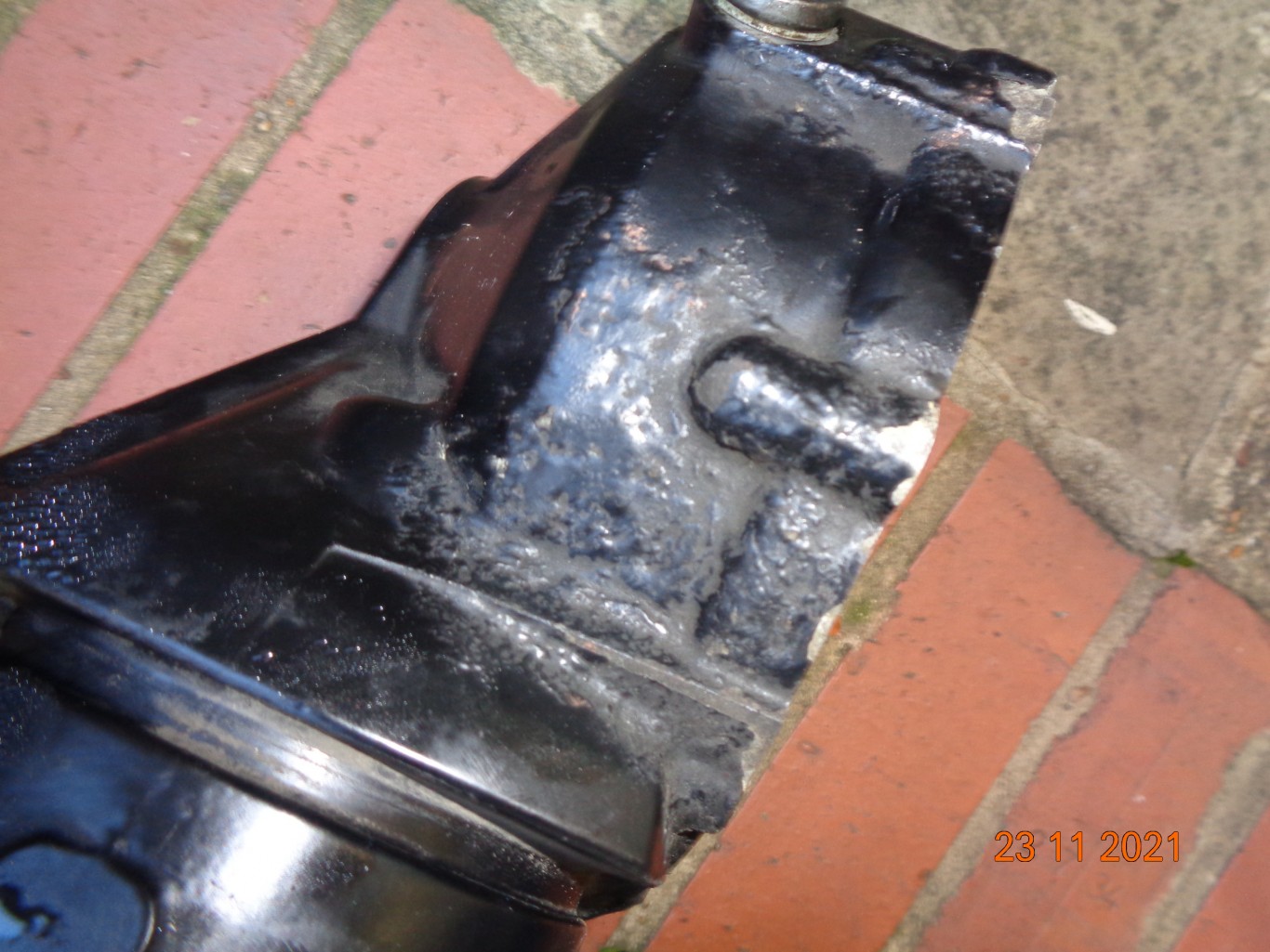

Hi there,
I'm after a little bit of advice / guidance.
As it's now winter in the UK I ave decided that after 10yrs of being on the road and ridden through a lot of bad weather both in the UK and Europe, that it's time to give my TEX's rear bevel box and swing arm and final drive unit a good clean and clear off the damaged coating to make it look as close to new again as I can.
I have stripped out the swing arm and its bevel box and stripped them down as much as possible (you'll see the pics below).
The plan is (or was until it was scuppered) to get the items blasted back to bare metal and then get them coated or finished in whatever was the best I could afford.
However, my plan has been thwarted.
The swing arm is not a problem - the chap has readily agreed to blast it for me and prep it for finishing.  What he hasn't done though is taken on the components of the bevel box / final drive unit.  I can sort of see his point TBH.  He has stated that due to the bearings and other parts in there, once he begins any work on them, any blasting medium would potentially damage the bearings and he would not be happy taking that on.
My question is this:  Has anyone got round this in any other way?
All I can think of now is using a small abrasive wheel in a Dremel along with some paint stripper.  Obviously I would mask off as much as possible to prevent any ingress of material, but that's about all I can think of at the moment.  I'd also cover the items in some grease to hopefully catch any particulate that would possibly get into the workings.
I'd be grateful for any hints / tips or other info on this matter.
Thanks in advance.
Olly
