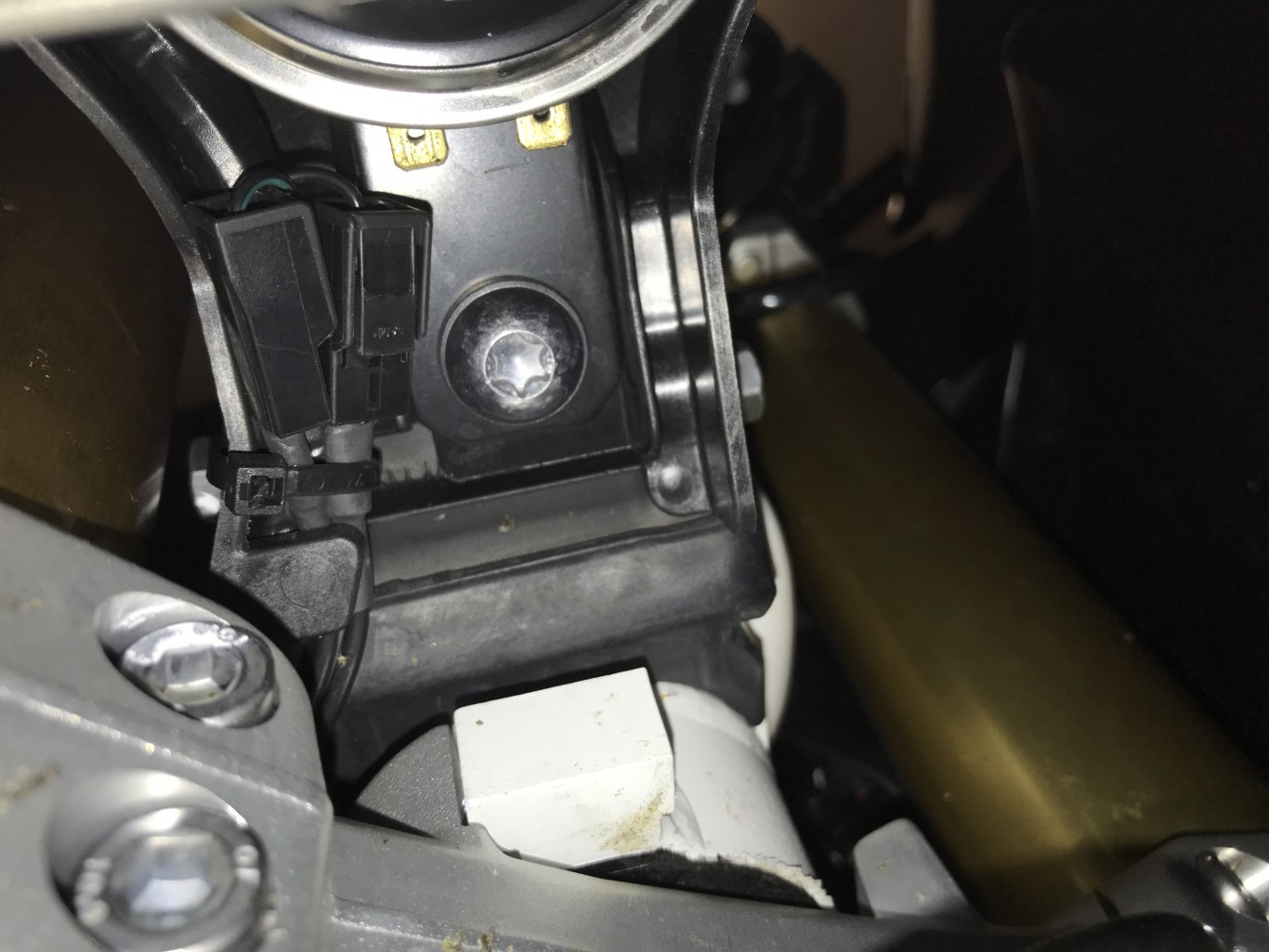

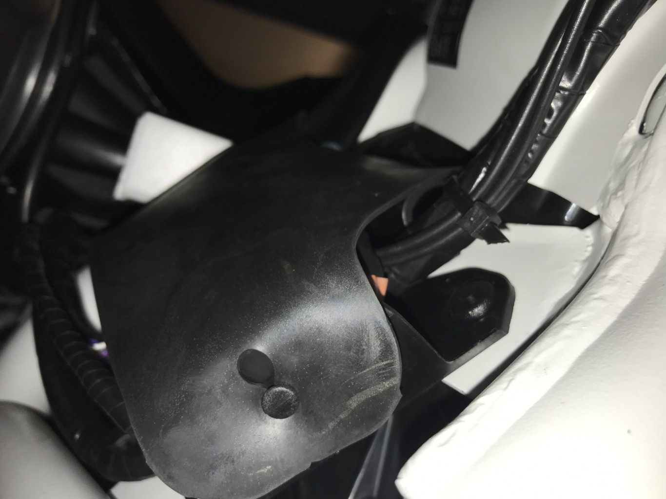

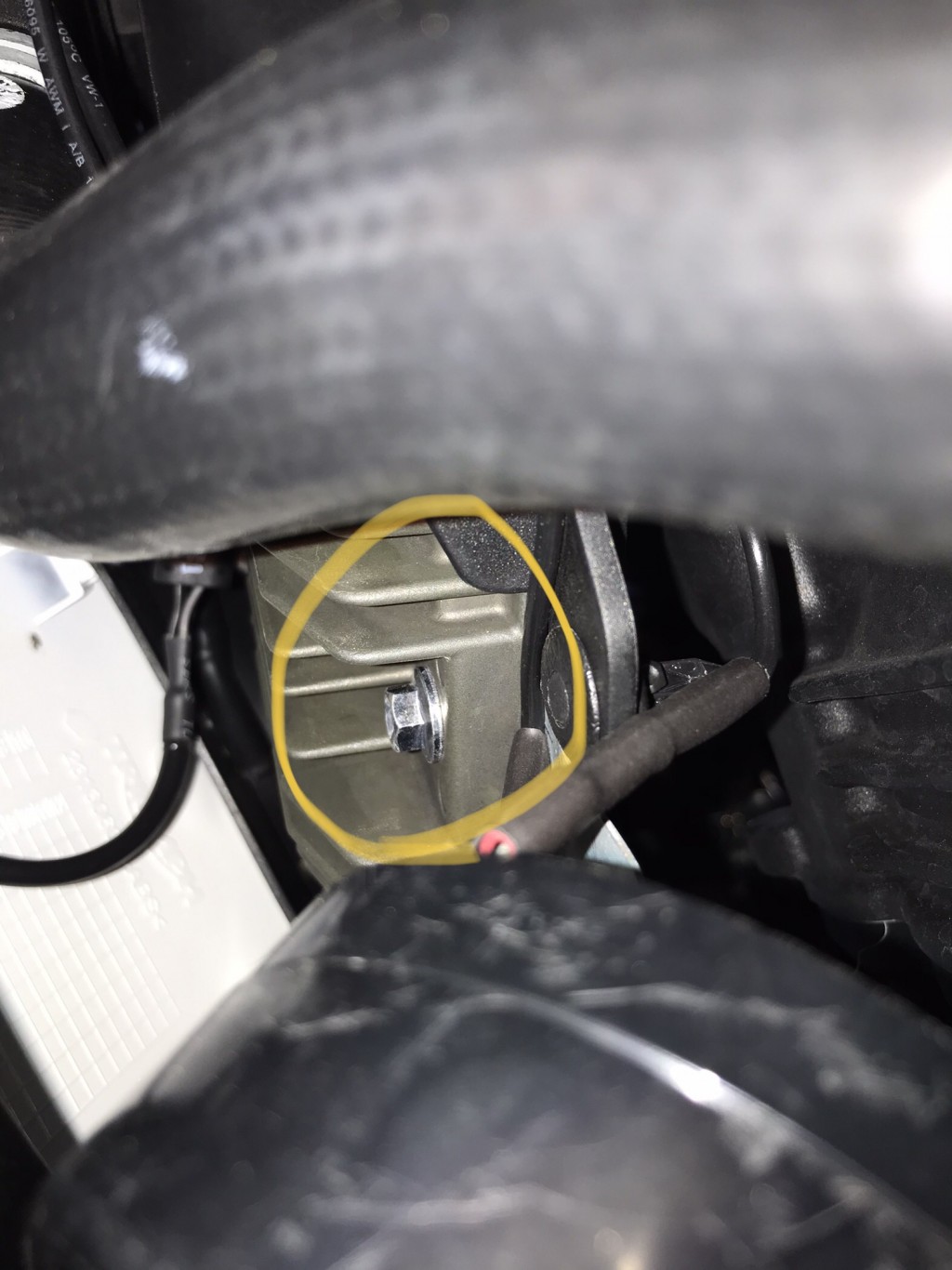

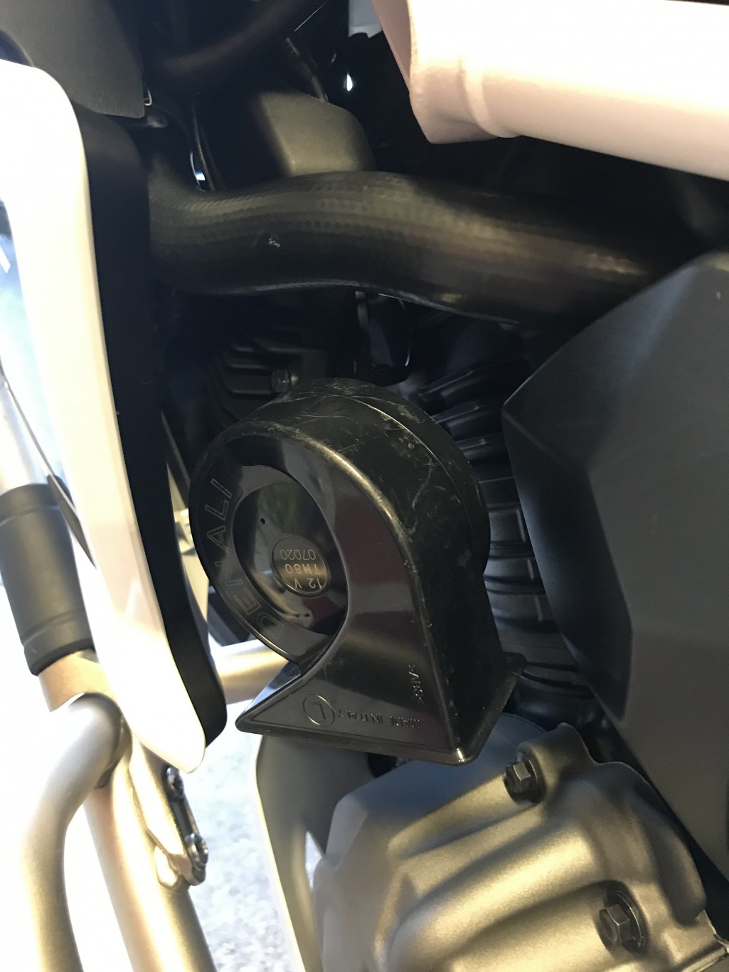

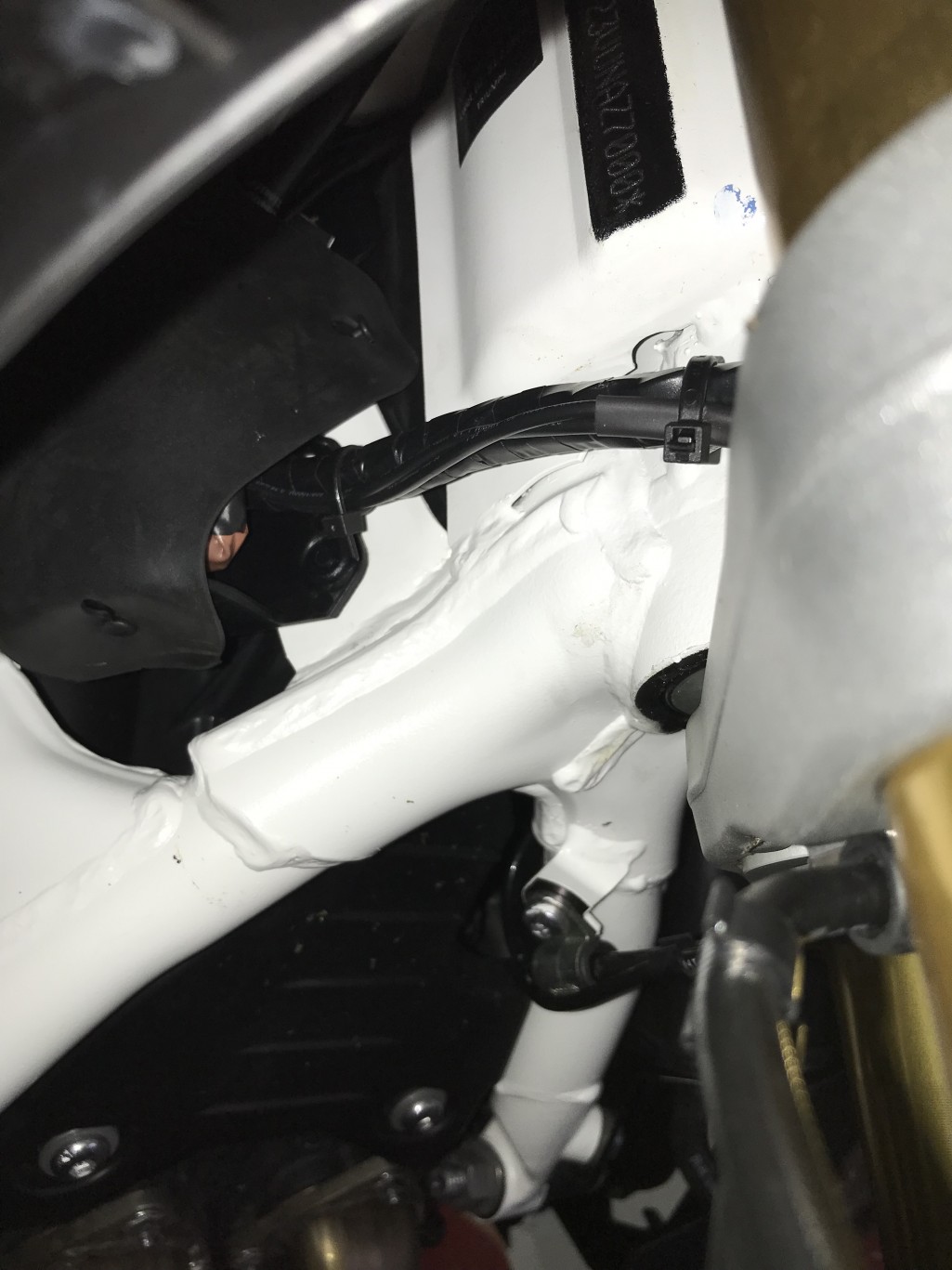

I've mounted a mini sound bomb tucked in the left fairing.
Used the thin mount bracket that came with it - I removed the circled bolt and slid the thin plate between the two parts, then re-inserted the bolt.
Ran a jumper cable from the original connection to the horn.
Under the plastic cover, across the top of the frame an down a gap near the radiator hoses on the left side.
Not as loud as the full unit but better than the original horn.
Hope this helps.
Lovetubs
